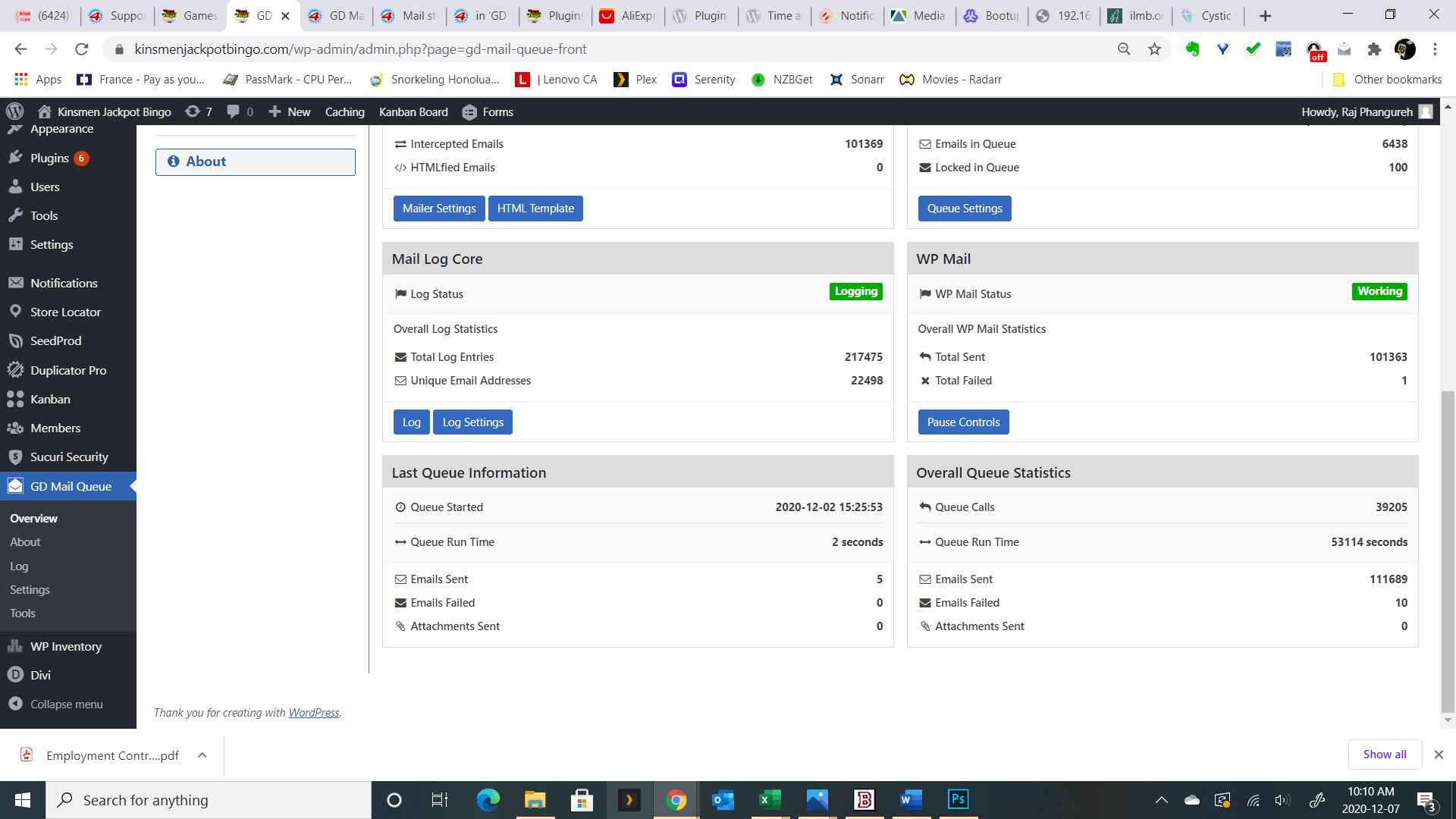

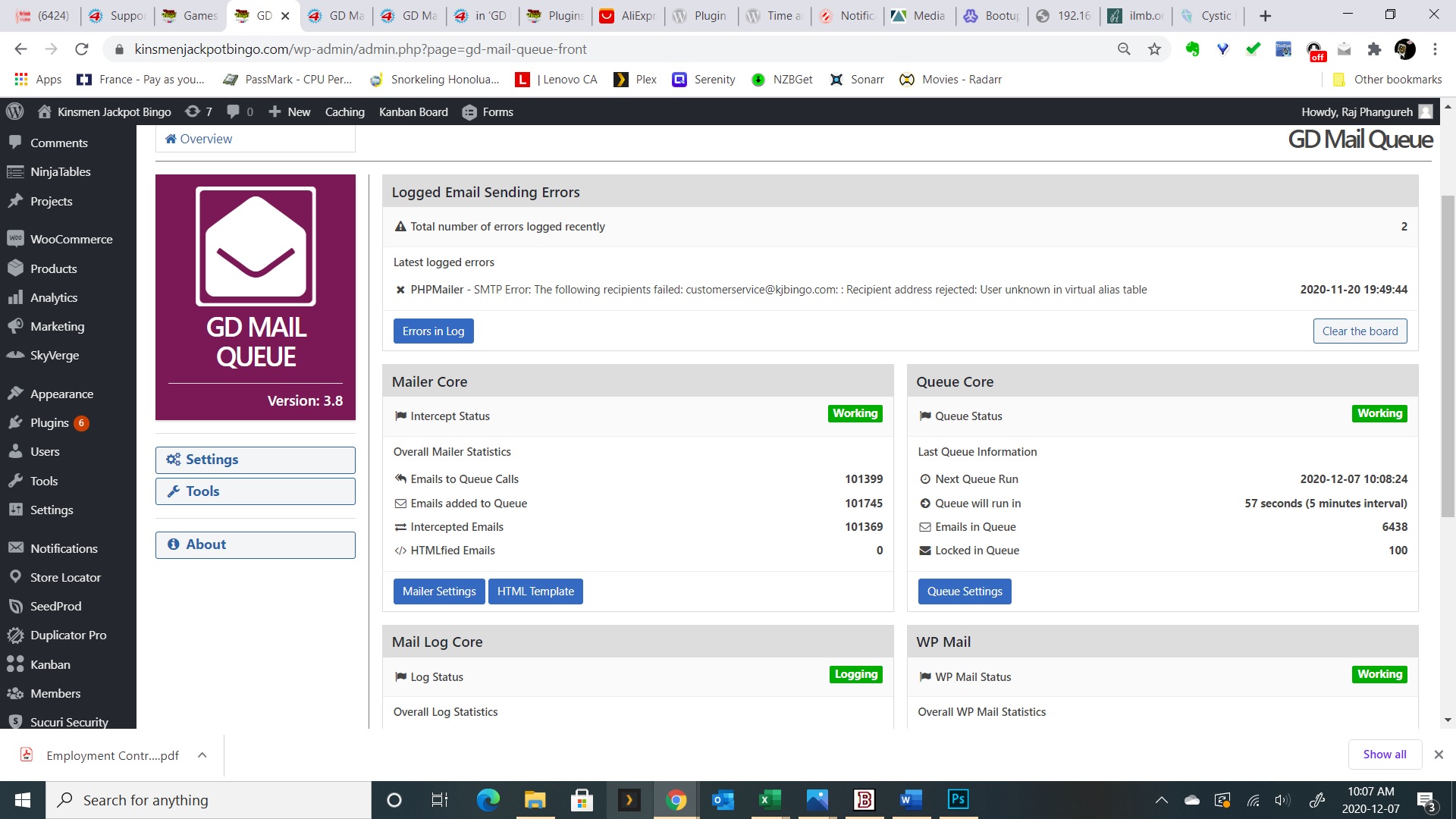

Hi there
Our mail seems to queue normally, but all our mail has been sitting in our queue since December 2nd without being passed on to the MTA. There’s over 6000 emails right now, and it shows 100 locked in queue. It’s always showing that the next queue will run in <5min, but when the countdown ends the queue hasn’t changed.
I’ve tried to select a couple of emails in the log that have been queued but not sent, and choose “Retry Sending” but it returns a “Nothing done” message.
Nothing I can think of has changed in my setup since December 2nd. I’ve checked the PHP Mailer settings and tried a few different mail server settings, and nothing seems to happen. The mail server settings are verified working on other clients.
Is there any other way to force this queue to send?

    I have not seen such a problem before, I am not sure what is causing it. Do you have some errors logged in the server PHP error log? Because this doesn’t look like the sending failed, because queue statistics have only one email failed, so something else is going on.
