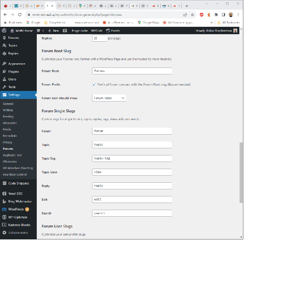

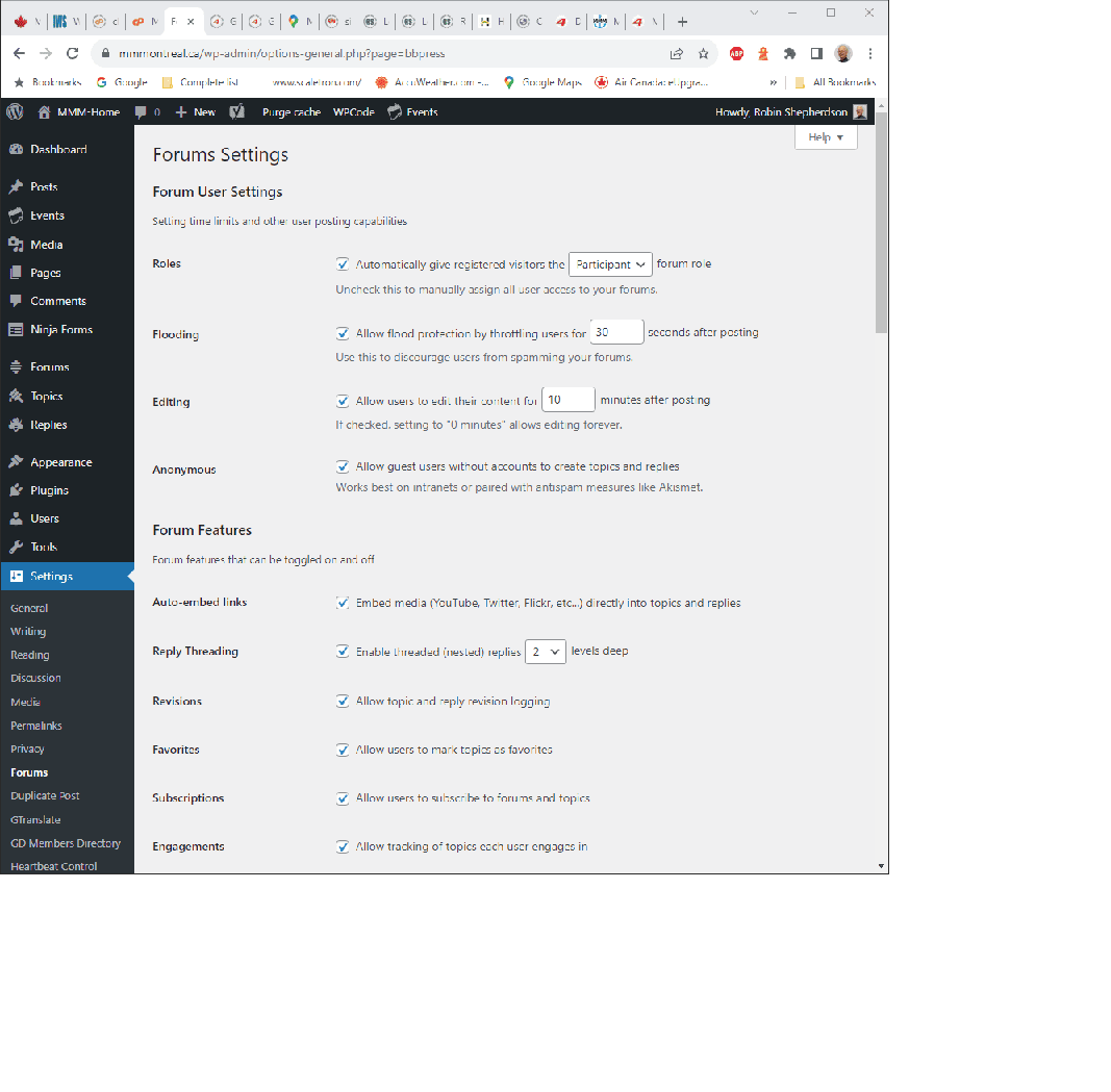

    The attachments are of the Forum settings. Which one should I change?
