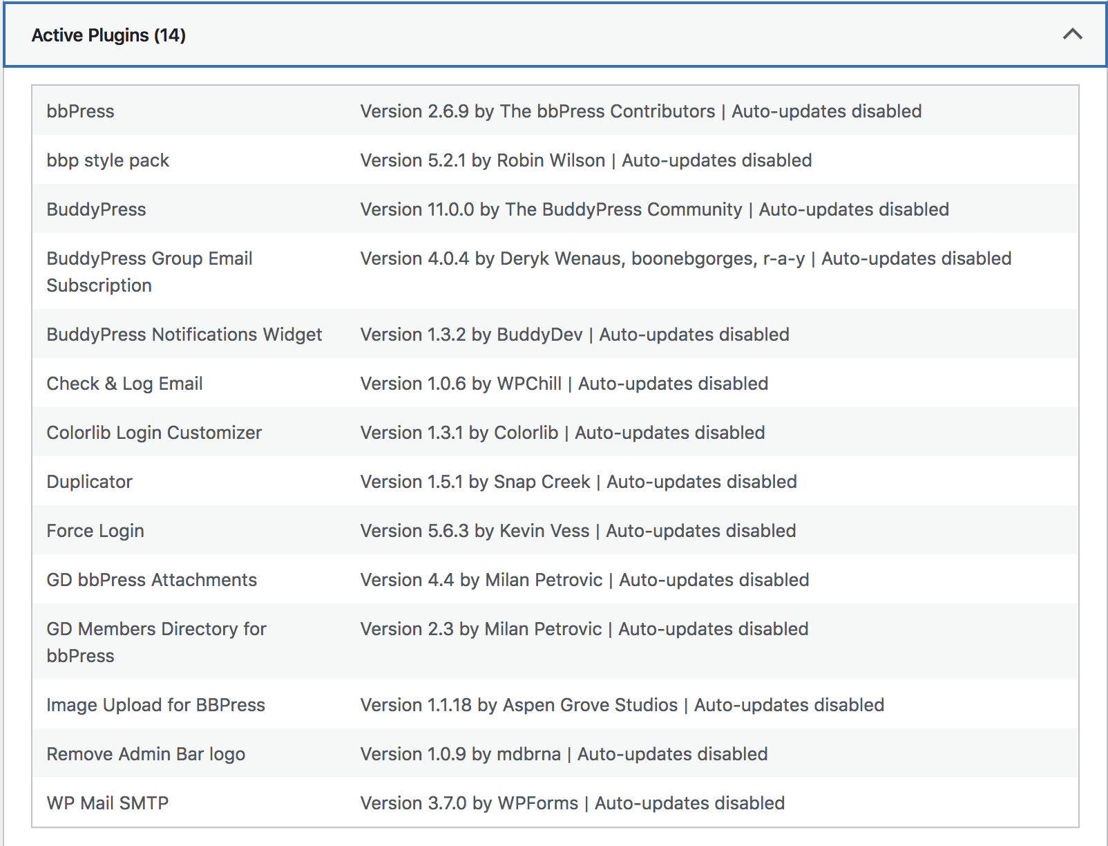

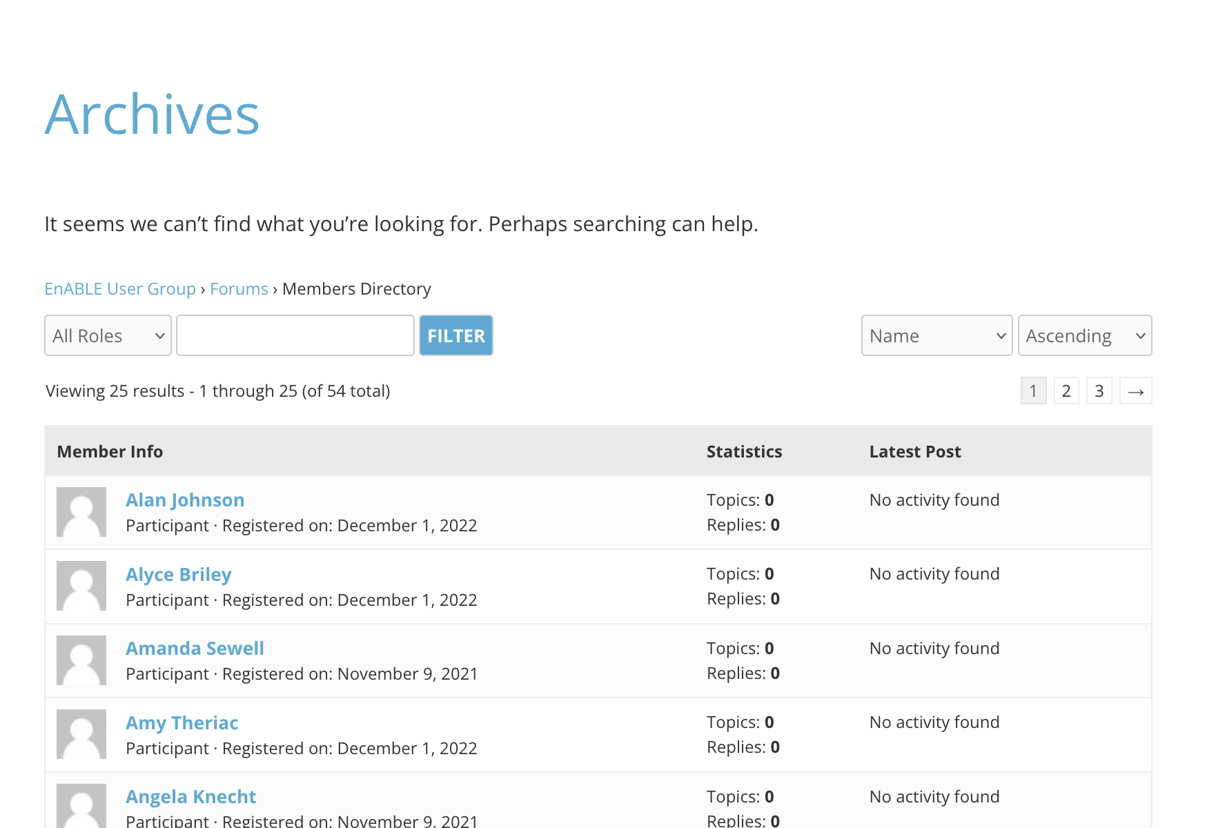

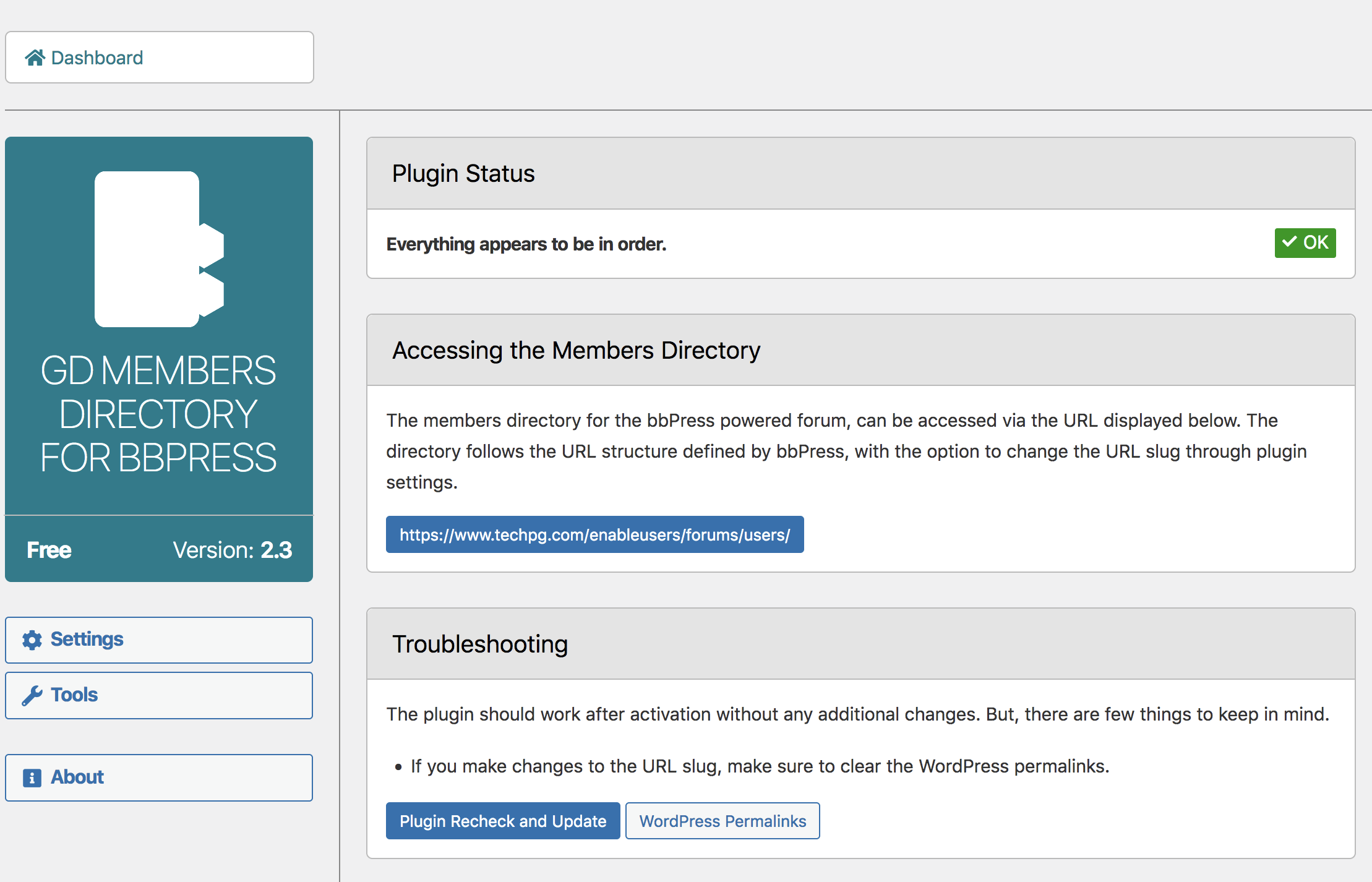

The membership directory plugin WAS working great. The menu link took you to a page that showed all the members with a title on the page that said Members Directory. After updating the BBPress plugin, it no longer works. The link goes to a page that says Archives but shows the members list in duplicate continuously down the page. What needs to happen to get it to work? Should I run the Plugin Recheck and Update? Not sure what this does exactly, so don’t want to do something that will screw things up.
Thank you for your help!
See attached screenshots. My WordPress version is actually 6.1.1

    It actually was the theme update that caused the problem. I reverted to an older version and it works now. The theme is ASTRA if you are curious.

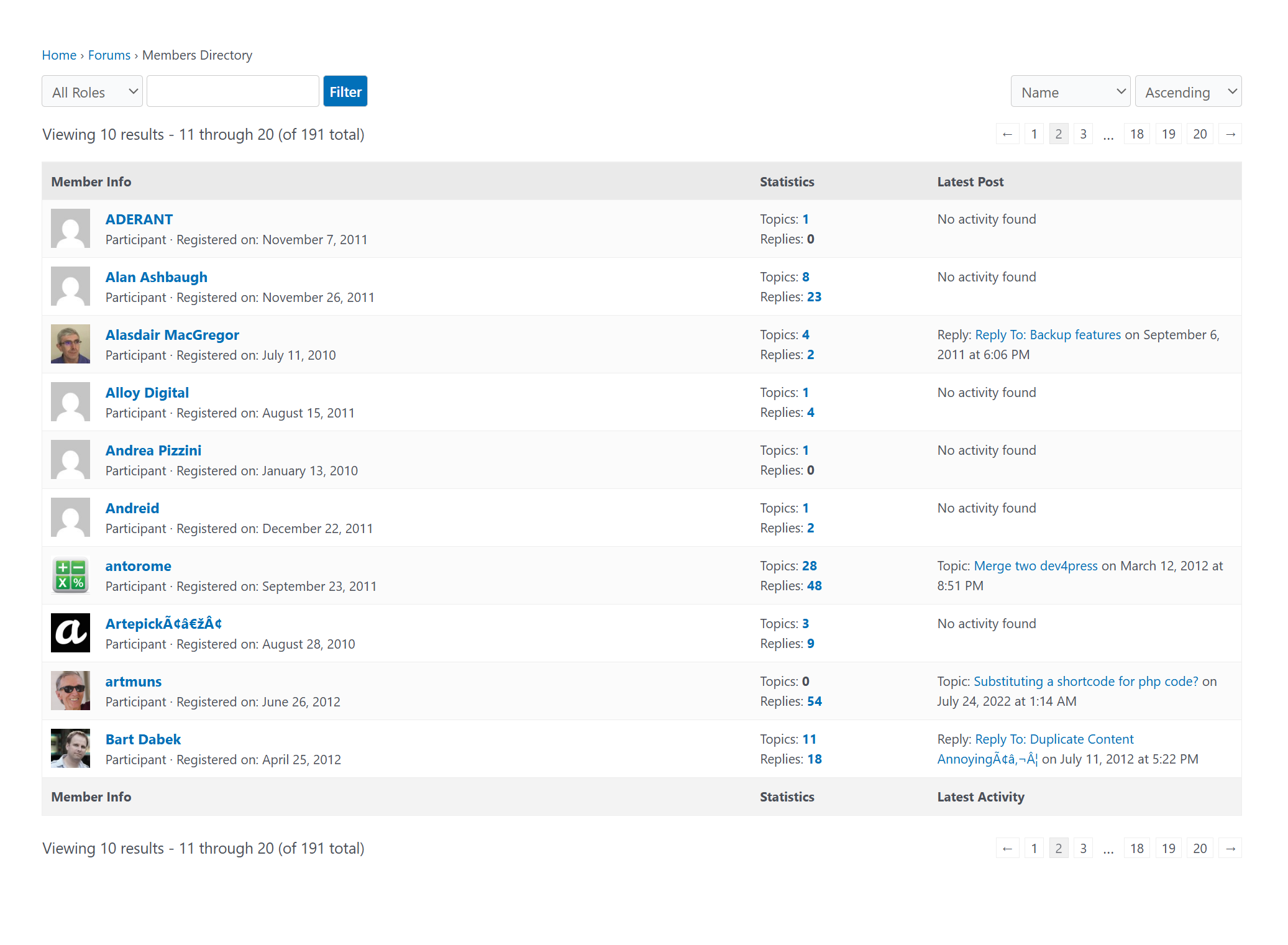

    Just as I typed my previous reply, I have seen that there was new update for Astra, and I am preparing update to my plugin too, so I tested. And, it seems that something changed, as the Members page works fine.
    astra directory
    I will release version 3.0 of GD Memebrs Directory tomorrow (it will be under new name: membersDirectory for bbPress).
