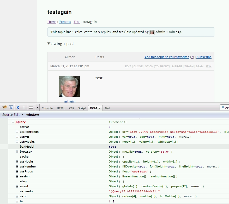

  • #15652
    Well, I dove in and loaded Firebug. If you look at the attached screen shot where active has a value of 0 I think that means it is not loaded.
    If that’s the case, then why isn’t it loading automatically? What can I do to load it?
    Thanks

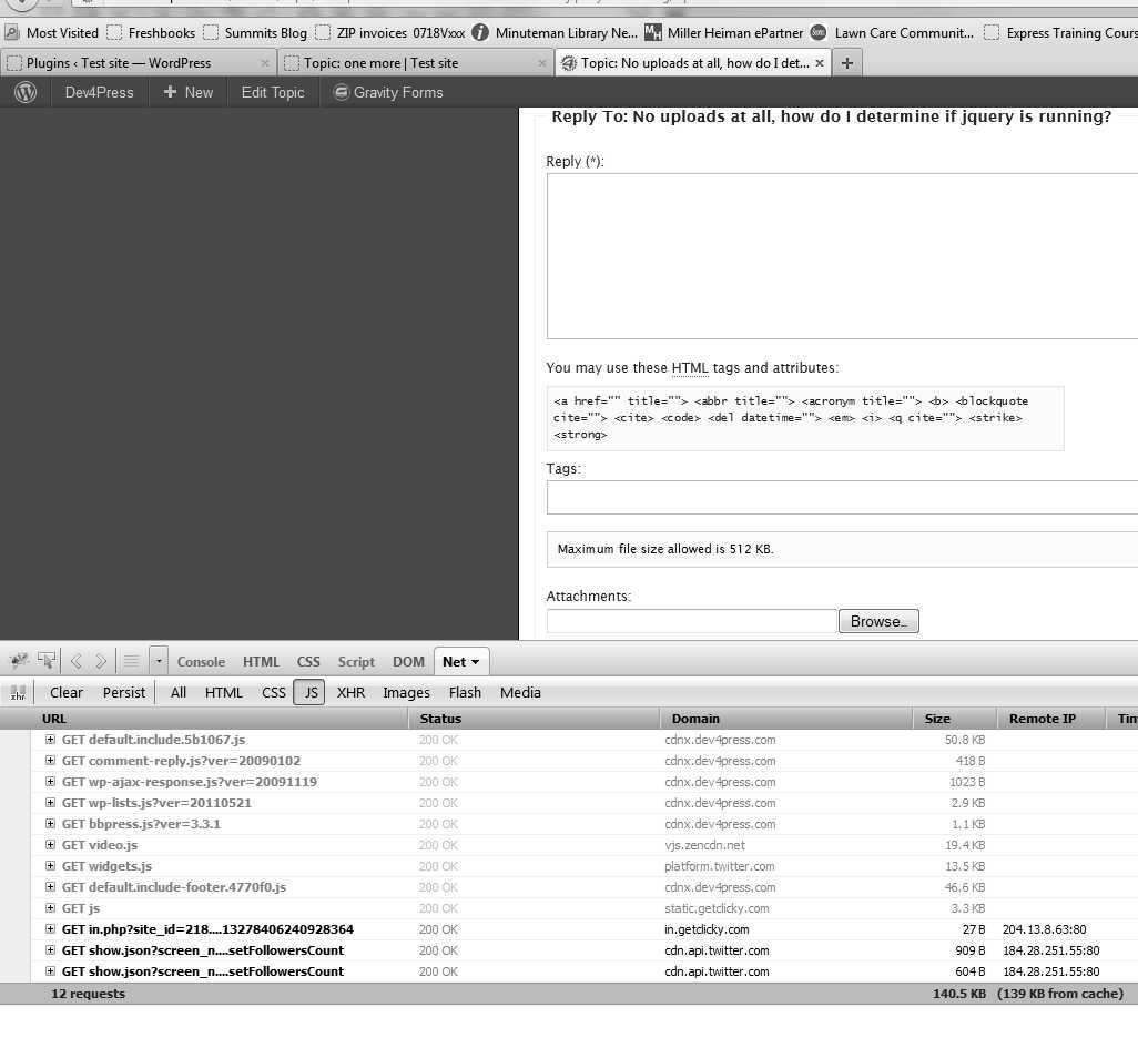

  • #15654
    Firebug console should display if there are any errors. Also Firebug NET/JS tab shows loaded files, jquery.js or similar should be there.
  • #15655
    Thanks for that. It shows no errors and it shows js running. See screenshot.
    This is as clean in install as you can get, WP3.3.1, twentyten/bbpress theme, and only bbpress and your plugin running.
  • #15657
    Yeah, jQuery loaded. But there is no upload fields present on the page, and that points to some misconfiguration of the plugin. Plugin should show upload automatically on installation, why that is not the case here, I am not sure.

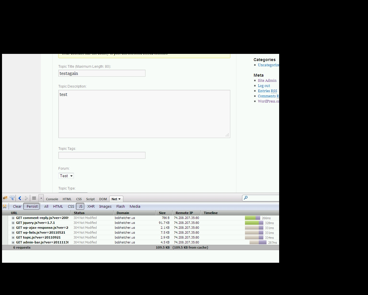

    I am running firebug when I do an attachment here and will post the screen shot so we can compare what happened when I did it on my site.
  • #15698
    Ok, here is the screenshot from when I ran firebug on this forum right after hitting SUBMIT button. It’s much different from the screenshot of my site that I posted above.
    Milan, I’ve played with every button/switch in the settings tab and none make a difference. This is a barebones test site and I am the only one with admin privileges.
    Your code is basically using the same upload functionality as in the basic WordPress upload used on any page when editing it, right? So, there isn’t some chmod 777 or anything I have a play with.
    I really appreciate the time and effort you’ve put into helping me.
  • #15700
    In your case upload code is not added at all to the topic/reply form, and that is a problem. So far that happens only when the theme is not done correctly and elements from it are missing or when the settings are not OK.
  • #15707
