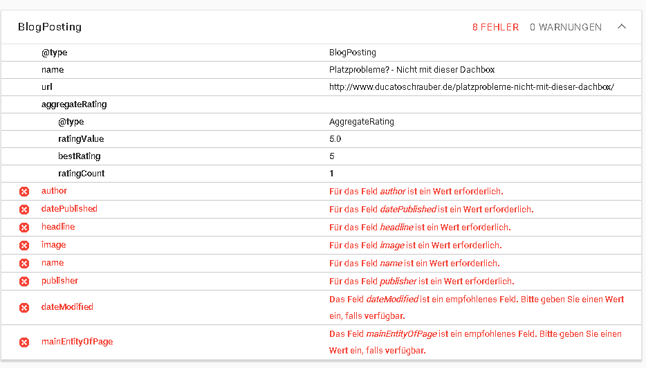

Hello,
I’m using your plugin “GD Rating System” for the first time. You did a great job, thank you very much!
But I’m still working on the rich snippets for google. I used the itemscope “BlogPosting” for my posts.
This worked really fine, but when I tested a post with the rich snippet tool by google, it tells me, that there a many values missing. You can see it on the picture.
Can someone help, why the values are missing?
Cheers, Tobi

  • #52940
    Hi,
    Thanks for reporting this. It looks like the requirements for some Item Scopes have changed. Problem is that some of this elements can’t be found in the WordPress at all, and it might require use of filters for website owner to fill the data outside of the plugin. Right now I am not sure how this can be solved. But, I will investigate and try to solve it for next version.

  • #52941
    Hi Milan,
    thanks for your answer.
    Sounds good, maybe some scopes are not needed for wordpress.
    Is there a scope I can use instead of “BlogingPosting” that will work as a rich snippet?
    Should I use “Thing” as a scope for a post ?
    Regards,
    Tobi
  • #52943
    Thing is the basic one and it doesn’t require anything special to work. But, the best thing is to experiment, considering how Google makes changes in that area very often.
  • #52944
    I tested the “Thing” thing.
    But it says “The aggregateRating property is not recognized by Google as an object of type Thing”
    Sorry, but I don’t understand, why this happens.
  • #52947
    Well, it seems that Thing is a way to general, and it doesn’t include ratings. CreativeWork, WebPage, Product, MediaObject should be safe to use. There are many other itemscopes you can try, they should belong to the Thing, but you need to test them to see what arguments are needed (or if rating can be used): https://schema.org/docs/full.html.
  • #52949
    Ok, I get it :)
    Thank you very much.
    I was just wondering because none if the Scopes really describes what it is about.
    But finally it works.
    Keep on going your work! I really appreciate.
